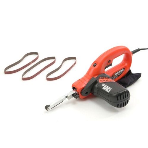

Does anyone use one of these Powerfiles?
It's basically a 13mm belt sander.
We bought one a few weeks ago when the Padauk neck
was proving to be particularly intransigent and chipping and tearing with chisels and spokeshaves.
With about 15 minutes work the neck and heel were basically finished apart from a hand sand
We figured it had paid for itself in one neck!!!
The cost over here about $95AUD(Pacific Pesos)
I did a quick archive search and couldn't find anything similar so I thought the info may be of use.
Bob

I have seen them but had not heard of anyone trying them...thanks for the post...it looks like a really clever tool for tight spots and I can see why it would be super for things like a neck, expecially the heel.

   You know I've seen air grinders used in that configuration for auto body work, but I never really thought of using something like that on wood! I bet that would do it to it!

Nice suggestion. I still think the ultimate weapon is the rotary chainsaw blade that Mario and I believe Sylvan use in their neck construction. It's called the Lancelot and it's very formidible and scary!!! See Mario's article in one of the recent issues of "Guitarmaker".
I use the belt sander as illustrated in John Mayes' DVD's as my main stock remover and then settle down to the rasp, spokeshave, file and sandpaper to finish it off.

I use an ArborTec Pro instead of the Lancelot for neck roughing out & shaping of plates on archtops. It's another bit of Aussie ingenuity - has three small carbide teeth that can be rotated when dull or replaced when needed. Much easier than sharpening a Lancelot and the small teeth keep it from grabbing the wood.
That belt sander looks like it will be a good companion for finishing up the rough surface left by the ArborTec.

Another alternative to you "chainsaw" luthiers is using the angle grinder mounted Kutzall that Lee Valley sells -- a lot smoother cutting and less scary than using a Lancelot or ArborTec.
I'm with JJ -- I find you can rough shape a neck on a stationary belt sander fairly quickly (and a lot less scary than an angle grinder).

What's with all the heavy weaponry? I'm happy with a sharp spokeshave.

I like to wear out yard sale drills by using them with sanding disks for rough shaping jobs.
